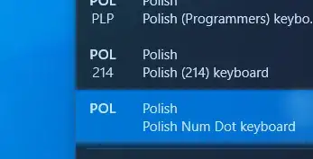

Adding Polish to see if the same could be done there shows no luck. The only available Polish (Programmers) QUERTY and Polish (214) QUERTZ neither have . as a numeric pad decimal separator.
But I was able to make a native working Polish layout with dot on numpad with MSKLC. Load existing keyboard > edit project properties > validate > build > install > restart.
Here is my build. It is installable.
