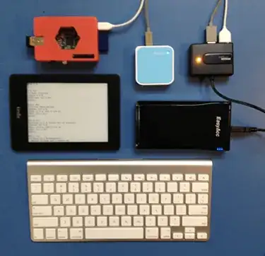

It is possible, but involves lots of work and is kind of useless.
You wouldn't call the end result a monitor, as such -- the Paperwhite logs into an SSH session, so it pretty much only works for terminals, as the lag between wireless keyboard and the e-ink screen is around 200ms.
An article about this exploit is published by Max Ogden :
Kindleberry Wireless: A Portable Outdoor Hackstation.
I will not reproduce the list of required hardware, but here is what the finished product looks like as a complete Raspberry Pi workstation :
