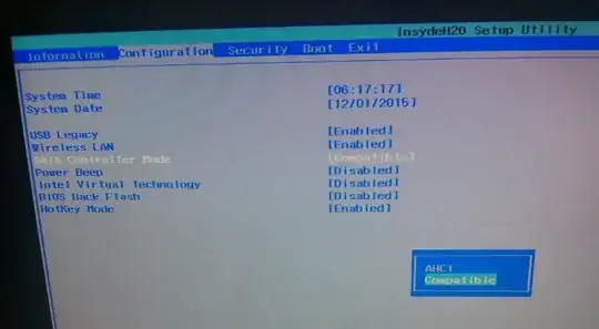

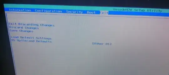

As requested, here are pics of the GUI for the motherboard hardware(i'll try not to say BIOS). I'll include a pic of the BSOD too which appears when booting the motherboard firmware set to legacy mode.
In the boot tab, choosing UEFI, causes the security tab to have the secure boot option which can be enabled or disabled.
The exit tab has an option "os optimized defaults" but whether set to win8 or other os, I get the same errors. The BSOD when set to legacy. The red bar when set to UEFI.
And I don't think setting SATA between AHCI and Compatible, makes any difference to the symptoms. (not that it should).

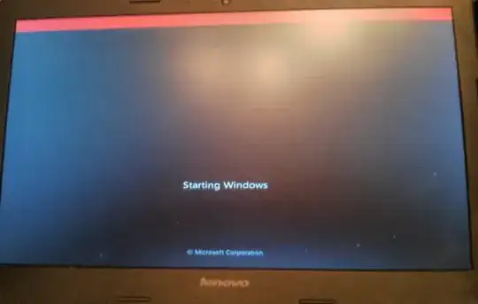

And the main error screen i've shown you earlier.. The red bar while the 'starting windows' image/text appears. That's UEFI with secure mode disabled. No image below because it's above , it's the first picture in the post. Really the only two relevant pics are the red bar one and the BSOD one. The load of UEFI pics were requested though.

  • I had a similar issue with my Dell laptop: http://superuser.com/a/583227/174557 look for such an VGA ROM setting – magicandre1981 Dec 01 '15 at 05:37
  • My BIOS doesn't have that many options. But choosing Legacy resulted in a BSOD like http://superuser.com/questions/1005972/error-with-winpe-the-bios-in-this-system-is-not-fully-acpi-compliant and choosing UEFI resulted in the red bar. – barlop Dec 01 '15 at 05:52
  • @magicandre1981 I already described the options so I don't know what you think you are going to see, but as you wish... and while in that comment I used the word BIOS, it's technically incorrect and a slip on my part.. As you perhaps know, it's not really a BIOS is it. As I understand it, It's UEFI set to either UEFI mode or legacy mode.. It's motherboard firmware / the GUI for it... Not a BIOS these days. So probably not a good idea for you to call it BIOS 'cos that's wrong terminology as I understand it. – barlop Dec 01 '15 at 06:40
  • hm, this looks like you cant change it. Without the VGA ROM you see the hang as Win7 doesn't support UEFI Graphic boot: https://support.microsoft.com/en-us/kb/2828074 – magicandre1981 Dec 01 '15 at 18:45
  • @magicandre1981 The computer does support legacy though. (and btw with legacy mode it gives a BSOD). – barlop Dec 02 '15 at 00:00
  • yeah, but in UEFI boot it doesn't support this VGA option ROM. call the Lenovo support and ask for an UEFI update to allow VGA option ROM in UEFI via option in the UEFI. If you don't like the preinstalled Windows 8.1, install StartIsBack+(http://startisback.com/), AeroGlass (http://glass8.eu/) and a Win7 style theme to have a Win7 look. – magicandre1981 Dec 02 '15 at 05:27

  • yes, win7 doesn't support this UEFI GOP (Graphics Output Protocol) and requires VGA. Win8 supports GOP and reads the UEFI Logo and displays it during boot for a smoother boot: http://blogs.msdn.com/b/b8/archive/2011/09/20/reengineering-the-windows-boot-experience.aspx And it seams that your UEFI always turn GOP on and disables VGA so Win7 can't be used. – magicandre1981 Dec 05 '15 at 07:38

Windows 7 doesn't support the new UEFI GOP (Graphics Output Protocol) and requires VGA option ROM (BIOS interrupt 10 (INT 10H)). Win8/10 supports GOP and reads the UEFI Logo and displays it during boot for a smoother boot. And it seems that your UEFI always turns GOP on and disables VGA, so Win7 can't be used and hangs at Starting Windows with the graphic artifacts.

  • Though bear in mind I wrote "The exit tab has an option "os optimized defaults" but whether set to win8 or other os, I get the same errors. The BSOD when set to legacy. The red bar when set to UEFI." So that option didn't work in my case. – barlop Jan 31 '17 at 10:10
    please state your laptop model, and verify that you were installing windows 7 It must be that your laptop supports the VGA Rom option inherently with "other OS".. in UEFI . Makes me wonder what "other OS" was doing in that laptop I tried that it didn't work. – barlop Jan 31 '17 at 10:11
