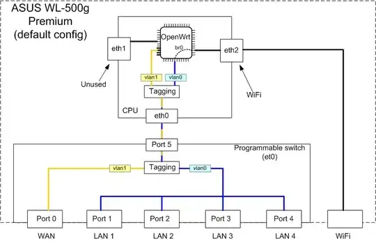

[non native English poster] Usually, in a domestic grade router/switch/AP device, the WiFi and ethernet are on two different physical interfaces. One interface for all the wired connections (WAN and LAN) and the other one for WiFi (WLAN). The first interface is divided in two vlan's, one for WAN (wired internet) and the other vlan is for the LAN (all the switch ports of your wired internal network). That second vlan should be bridged in some way with the physical interface providing WiFi. If that bridge does not exists or has been disabled in your D-Link, than you might not be able to connect wired and wireless device together, even if they belong to the same subnet.
Here is a typical router diagram (from openWrt.org). See the br0 bridge?
https://wiki.openwrt.org/_media/oldwiki/openwrtdocs/asus-internals-default.png
Check if you can find any option in the D-Link config to bridge wireless to the wired switch ports.
