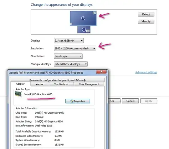

I have tried everything I could find out there, but there is just no way my laptop sets the nVidia GPU as primary chip. I have a 28" 4K monitor plugged on the DisplayPort, and it keeps using the Intel integrated graphics.
System : W7 x64 laptop, core i7, 16 GB RAM, nVidia 880M
I have set "Force nVidia" in the nVidia control panel, rebooted, no effect at all. Keeps using Intel.
I have uninstalled nVidia drivers, reinstalled the latest one, rebooted, no effect.
I have forced disabling the Intel chip, but the PC restarts as if there is no other graphics card installed, without Aero effects and with very laggy display.
I have enabled "High performance mode" in energy settings.
My BIOS is mainly informative and does not allow disabling, forcing or acting on the graphics cards.
Whatever I do, I still have laggy display on my huge 4K monitor because the laptop just won't use the nVidia chip.
I would greatly appreciate a miracle solution, thanks in advance.

  • According to CPU-z, the mainboard is a P15SM-A/SM1-A, the northbridge is Intel Haswell and the southbridge Intel HM87. The laptop manufacturer would in fact be Clevo. I'm gonna look for a bios update, but I don't like that, as it is quite a hazardous operation and I doubt a new bios will suddenly allow tuning the graphics card. – Jeremy Thille Dec 15 '15 at 14:39
  • It looks like games are using the nVidia chip, because I can play in 4K with high settings and they're fluid. However, Windows itself keeps using the integrated graphics, and thus is quite laggy when it comes to scrolling, moving stuff around and so on. – Jeremy Thille Dec 15 '15 at 14:50
On your laptop, all your displays are connected to the Integrated GPU (the Haswell - based Intel HD Graphics 4600), something you can confirm by:
  1. Navigating to the "Set PhysX configuration" tab on the Nvidia Control Panel. It will show you how these displays are wired to the Intel Integrated Graphics controller.
  2. Opening the Intel HD Graphics control panel, from where you'll be able to adjust advanced display settings for the 4k panel you have.

  • Hi, sorry for the delay. The "Set PhysX configuration" tab shows that both displays (laptop and 4k) are connected to the Intel HD. I can select "GeForce GTX 880M" in the dropdown, I clicked "Apply"... and it does nothing. I can't see "DisplayPort MST" option anywhere. – Jeremy Thille Jun 29 '17 at 16:35
    Hello, it would seem that my answer is correct, and that for some reason, DisplayPort MST is unavailable for your system. It's mostly activated with daisy chained setups or a monitor with dual DisplayPort in ports. So for now you'll have to do with the Integrated Graphics solution. Secondly, the PhysX page does show the display output panel setup, however, it has no direct control on outputs UNLESS the Nvidia GPU is wired to a monitor directly, which is not the case here. Toggling the options here only enables Nvidia PhysX offload to the dedicated GPU. – Dennis Mungai Jun 29 '17 at 22:27
