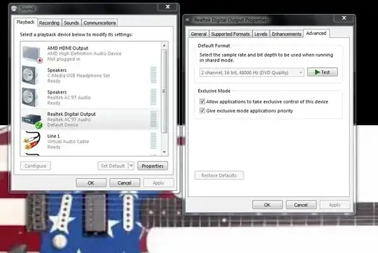

I'm running Windows 7 SP1 x64 on an ASUS M2N4-SLI, which has a coaxial digital audio output (see my profile for more HW info - it's system PC1).
How do I force Windows 7 to output 5.1 Surround to my receiver? When I go to the Properties for that sound device, and I select to test Dolby Digital, I get surround output, but after completion it switches to stereo. How can I get 5.1 Surround 24/7?
EDIT: Here's a snapshot of my audio settings:
Audio settings image
It seems that it's being forced into 2 channel mode by something, but I don't know what. I'm open to any suggestions.

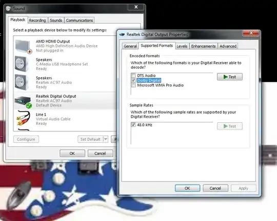

Here's what I did:
  1. Go to Sound --> Playback --> Realtek Digital Output --> Properties --> Supported Formats and select only Dolby Digital.
Supported Formats Window
  1. Select |> Test.
  2. While Windows is sending the test signal, set the receiver to Auto Sound Digital mode, and the Listen Mode to Pro Logic.
  3. After test completes, click Yes.
I can now listen to anything I want in 5.1 (ish - see below) surround.
The only issue is that the two rear speakers (the surrounds) are set to play the same signal, so it's really 4.1 surround (FrontR + FrontL + Center + Surround + Sub). This isn't too much of an issue, as it already sounds way awesomer.
