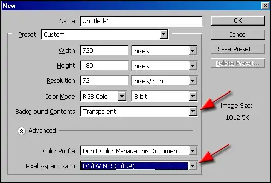

Pixels are not necessarily square!
In the past pixels have rectangular shapes. That's why in any professional image/video editor like Photoshop, Premiere, Sony Vegas... you see the pixel aspect ratio option. Only modern TV and PC monitor standards have square pixels.
Photoshop pixel aspect ratio
Famous examples:
  • PAL Analog TV/DVD: 720x576 which is obviously not 16:9 or 4:3 but 5:4. However when setting the correct pixel aspect ratio it'll produce the correct unstretched output image
  • NTSC Analog TV/DVD: 720x480 which is 3:2. After setting the aspect ratio it'll become 16:9 or 4:3 like PAL above. The lower vertical resolution also explains why NTSC DVDs look a lot less crisp than PAL
  • VCD: PAL 352x288, NTSC 352x240. Both use 4:3 screen aspect ratio
  • SVCD: 480x480, and unsurprisingly it doesn't produce a square output
  • DV: 1440x1080 16:9 full HD resolution
  • CGA: 320x200 and 640x200 in 4:3 (yes, older computer screens do have rectangular pixels)
  • EGA supports 640x350 for 4:3 screens in addition to 320x200 and 640x200
Adobe Premiere Pro - Working with aspect ratios

    This answer could be improved by explaining a little more about aspect ratio (as opposed to just a link). It is not clear, by itself, why a particular screen resolution can't have square pixels. – Jon Bentley Dec 31 '15 at 17:15
    I don't understand the link between the square pixels and the resolution. – A.L Jan 02 '16 at 16:32
  • @A.L as I already stated above. 720:576 is 5:4 and if pixels are square, it'll result in a 5:4 aspect ratio. However if pixels aspect ratio is set to a value different from 1 it'll produce a different aspect ratio. But where did I say about resolution here? I just said aspect ratio – phuclv Jan 02 '16 at 16:38
  • @JonBentley where do I say a particular screen resolution can't have square pixels? Obviously you can have a 5:4 720x576 screen if the pixels are square. What's important is the final picture's aspect ratio and that's the combination of pixel aspect ratio and screen aspect ratio – phuclv Jan 02 '16 at 16:40
  • I see, now I don't understand the link between videos format and the OP question: *Pixels in screens are square, but I'm not sure why.*. – A.L Jan 03 '16 at 10:49
    @A.L: This answer proves that not all pixels in screens (or file) are square: some are rectangular. – slebetman Jan 04 '16 at 03:10
