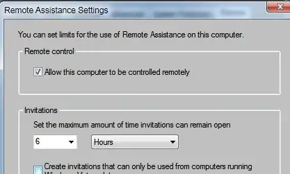

Did you adjust remote settings? Right click My Computer, click on remote settings, be sure check box is ticked. In advanced, have check box for Allow remote Assistance ticked
11111
Carl B
  • 6,660
  • 46
  • 66
  • yes, they are ticked – Feyyaz Jan 01 '16 at 15:06
  • On a Windows system, that might explain why [RDP](https://en.wikipedia.org/wiki/Remote_Desktop_Protocol) would not work, but wouldn't explain why a system wouldn't send ICMP [echo replies](https://en.wikipedia.org/wiki/Ping_%28networking_utility%29#Echo_reply) to ICMP [echo requests](https://en.wikipedia.org/wiki/Ping_%28networking_utility%29#Echo_request) sent by the ping utility on another system. – moonpoint Jan 01 '16 at 15:26
