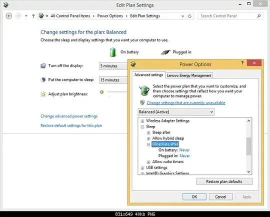

I found out that the laptop wakes up exactly 3 hours after I put it to sleep, so I googled again using this new piece of data.
Paradoxically, my laptop (and probably many other laptops) wakes up in order to hibernate, but for some reason the hibernation fails - resulting with the laptop "staying awake".
Solution
Right-click on the Start button and select "Power Options".
"Change when the computer sleeps" > "Change advanced power settings"
"Sleep" > "Hibernate after"
  • On battery: Never
  • Plugged in: Never
Source: eightforums.com

  • This is a **workaround** (not actually a **solution**). If you keep the PC sleeping for a prolonged time, it will drain the battery. – sancho.s ReinstateMonicaCellio Jul 13 '16 at 05:51
    @sancho.sReinstateMonicaCellio not at all. My laptop is not on battery when this happens so definitely solves a problem for me. Also, hibernation is disabled on my laptop so this setting should not be enabled anyway. – Hans Løken May 25 '20 at 15:33
  • @HansLøken - Good to know. – sancho.s ReinstateMonicaCellio May 25 '20 at 20:11
    I have a theory. I had Hibernate un-checked from the "Choose what the power buttons do" menu, so the system was not supposed to actually hibernate, but all of my "Sleep -> Hibernate After" options were set to 3 hours, and I saw the same symptoms as above. I just disabled Hibernate completely (`powercfg /h off`) so now "Sleep -> Hibernate After" is totally gone; hopefully, that stops the wee-hours wakeups. – James B Aug 10 '20 at 16:45
