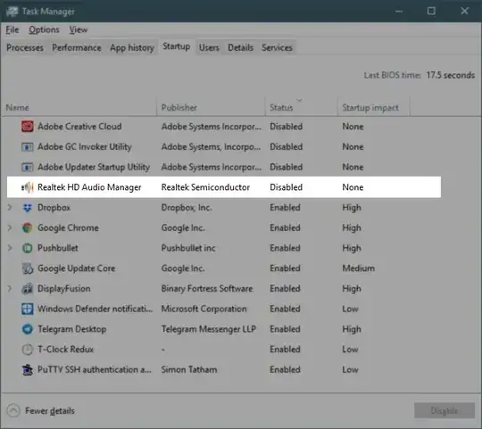

For those with no success with the previous suggestions: In my case (Windows 10 Version 1803 build 17134.254), what finally did work was to go to Task Manager > Startup tab, and right-click on the Realtek HD Audio Manager and select Disable.
Screenshot
