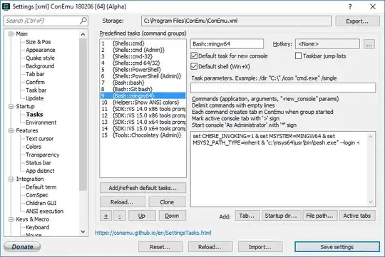

What to do is actually pretty simple, once you peel all the layers away. This works well as an invocation (make sure to modify it to your specific MSYS2 install location):
set CHERE_INVOKING=1 & set MSYSTEM=MINGW64 & "c:\msys64\usr\bin\bash.exe" --login -i
I would personally recommend setting the shell to inherit your PATH:
set CHERE_INVOKING=1 & set MSYSTEM=MINGW64 & set MSYS2_PATH_TYPE=inherit & "c:\msys64\usr\bin\bash.exe" --login -i
My ConEmu Tasks settings page ends up looking like this: ConEmu Startup::Tasks Page
Breaking it All Down
MSYS2 likes to configure the shell according to environment variables rather than command line parameters. Passing options into a program that way might seem unnatural at first, but basically it just follows this simple series: set VAR=value & set VAR2=value & "c:\path\to\command" [args]
  • CHERE_INVOKING - if set to 1, bash starts in the current working directory, otherwise it starts in the user's home dir. This needs to be set to 1 to allow the shell to work as-expected from the Explorer Window context-menu.
  • MSYSTEM - which MSYS2 subsystem to use. There are three: MSYS, MINGW32, and MINGW64. The MSYS subsystem should only be used for pacman command operations and so I typically only invoke that via the old-skool start menu icon on the very rare occasion it's needed. MINGW32 is useless to all by a select few users and you know who you are already, probably.
  • MSYS2_PATH_TYPE - if unset MSYS uses a minimal PATH environment that contains only MSYS binaries and a couple select Windows system paths, and is a required mode for MSYSTEM=MSYS shell only. For MINGW shells it's recommended to use inherit -- I've been using MSYS2_PATH_TYPE=inherit without issues for years.
There's another variable MSYSCON mentioned by another answer and referenced in msys2_shell.cmd -- ignore it. It's only for use within the msys2_shell.cmd batch file and holds no bearing on the behavior of bash.exe or MSYS shell initialization.

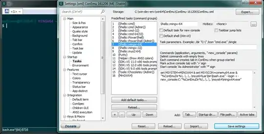

I also had problems getting MSYS2, MinGW32 and MinGW64 shells (v2016-12-07) to work in ConEmu v161206.
The only (half-portable) working solution I've found is the following.
  1. Create a new task with the name {Shells::mingw-64} and the following commands in ConEmu for the MinGW64 shell:
    set MSYSTEM=MINGW64 & set MSYSCON=conemu64.exe & "%ConEmuDir%\..\..\..\msys64\usr\bin\bash.exe" --login -i -new_console:C:"%ConEmuDir%\..\..\..\msys64\mingw64.exe"
  2. Create a new task with the name {Shells::mingw-32} and the following commands in ConEmu for the MinGW32 shell:
    set MSYSTEM=MINGW32 & set MSYSCON=conemu64.exe & "%ConEmuDir%\..\..\..\msys64\usr\bin\bash.exe" --login -i -new_console:C:"%ConEmuDir%\..\..\..\msys64\mingw32.exe"
  3. Create a new task with the name {Shells::msys2-64} and the following commands in ConEmu for the MSYS2 shell:
    set MSYSTEM=MSYS & set MSYSCON=conemu64.exe & "%ConEmuDir%\..\..\..\msys64\usr\bin\bash.exe" --login -i -new_console:C:"%ConEmuDir%\..\..\..\msys64\msys2.exe"

tl;dr: I recommend the first approach. Here is a screenshot as a proof in ConEmu:
Working MSYS2 MinGW64 shell in ConEmu
