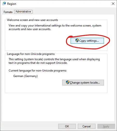

Now for the fix. Go to Welcome screen and new user account settings.
This might differ from build to build but I could get it under Windows 10, 1903 by
  1. Opening the Control Panel,
  2. Click on Region Region settings
  3. Switch to tab Administrative in the now opened dialog
  4. Click on button Copy settings… Region -> Administrative

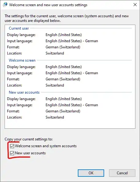

Welcome screen and new user account settings dialog will open. Then follow these steps
  1. Check both boxes at the bottom of the dialog Welcome screen and new user account settings dialog
  2. Restart (log off and log in again might be enough, would restart to be safe). IIRC Windows will tell you about restarting if this setting differs from the current one, which was the case for me.
  3. After the restart, Windows added the unwanted layouts again. Follow @Jan Palas‘ answer on how to remove them again by adding them and deleting them.
  4. Restart again or log off/log in again
  5. Profit and hopefully have a not so crappy Windows anymore. Haven‘t had the problem for almost a week now which is a miracle.
