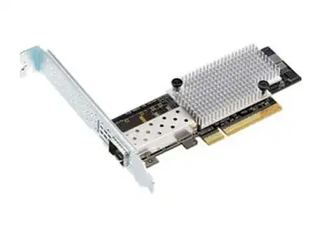

I would like to test 10Gig Ethernet serial interface by installing two NICs(Network Interface Cards) on a pc and pinging. I have the following questions:
1- Can two separate NICs be installed in one PC and have separate IP addresses (for pinging)?
2- Does this seem like a sensible approach to generate/check the data transferred over this interface?

  1. Yes
  2. Maybe. Depends on whether you get outsmarted by the OS. I have had issues in the past when trying to test FPGA designs that are connected via 10G ethernet to multiple NICs in one computer, and having all of my test packets get routed by the OS instead of going out on the wire (why is netperf going at 40G on a 10G NIC?!?).
alex.forencich
  • 619
1- Can two separate NICs be installed in one PC and have separate IPs
Yes. There is nothing special about multiple NICs in one system. I suspect it is even standard on allmost all servers, and both desktops setting next to me also have dual NICs (and soon a third, a pair of 10GBit NICs have been ordered).
The term for a computer with multiple NICs/IPs is "Multihomed"
No, dor several reasons.
  1. ICMP echo request (aka ping) is not a good test. Try to use something like iperf.
  2. Routing can get tricky. As can CPU usage. Best to split that cleanly into two systems.
  3. And, as Alex already mentioned. Sometimes the OS tries to be very smart. It is easier and more foolproof to test with two different computers.
