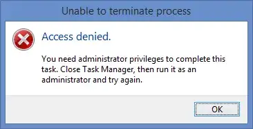

If the reason you had got the "Access is Denied" message was due to Task Manager not running as Administrator, you would get this very explicit message telling you so:

Yes, but you'd have to run it from a non-administrator account to see it.
