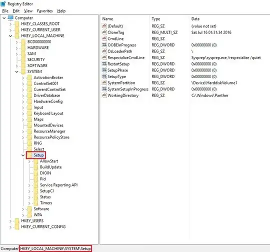

There is an excellent tutorial on Ten Forums pertaining to a separate topic:
How to Move Users Profile Folder to another Location in Windows 10
Within that tutorial, the author says the following:
We need to edit Windows registry to "fool" Windows to think this is a clean install instead of an upgrade. To do this open the Registry Editor (WIN + R, type regedit, hit Enter), browse to key HKEY_LOCAL_MACHINE\SYSTEM\Setup
Delete both the DWORD Upgrade (right pane) and KEY Upgrade (left pane), see screenshot.
The author's subsequent screen shot displays the appropriate entries in the registry:
Delete Upgrade DWORD
The following area within the registry seems to be the key to determining whether or not a Windows 10 install was an upgrade:
In order to prove this theory, I first initiated a clean install of Windows 10 on my test machine and scrutinized the same area of the registry. The Upgrade key is notably absent:
HKLM System Setup
