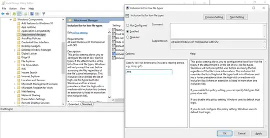

I don't know a way to trust that one specific program, but if you wanted to disable the prompt for all .exe files, you can do the following:
  1. Go to Group Policy (Either search it, or press Win + R and run gpedit.msc)
  2. Navigate to Local Computer Policy -> User Configuration -> Administrative Templates -> Windows Components -> Attachment Manager
  3. Find the item in the list on the right named Inclusion list for low file types, double click it
  4. Set it to Enabled and add .exe; to the box that appears below:
This should suppress this dialog, however as stated it should suppress it for all programs that would otherwise do this, so may not be the answer you particularly wanted.

  • Thanks Jonno, good answer but to a different question I guess. For security reasons, a blanket suppression for all EXE types is probably a bit incautious! :o) – AlainD Jan 31 '16 at 11:12
  • @AlainD Indeed, I recognise this isn't exactly what you wanted. :) Will see if there's a way to exclude a *single* application, but I'm not so sure. – Jonno Jan 31 '16 at 11:13
