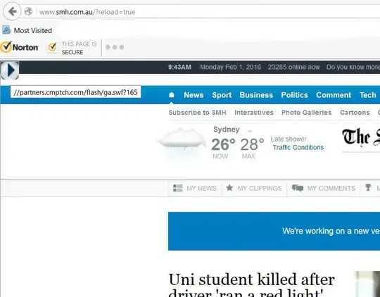

For the last few weeks I've had the following happening, using Windows 8.1 and Firefox V44. The only active add-ons are Adblock Plus, Flashblock and Norton Identity Safe:
  • First, Norton Internet Security (which assures me that all is green ticked and hunky dory in security-land) alerts me that there is a large amount of outbound traffic detected. It asks me if I want to run Power Eraser. I did this twice. Power Eraser's total contribution to safety and security is to get its knickers in a twist over the old Office.exe tool (left over from circa Office 2000, which I allowed it to remove) and the Registry setting that allows profiles to be loaded in Powershell. I haven't bothered using it again since.
  • Edit: As an infuriating aside I tried to run a full scan with Norton, but it refused to. I selected Full Scan, selected Go, and nothing happened. Nor could I bring up its options. In the end I ran Norton's diagostics and found that it recommended reinstalling the thing. Great, it shows me oceans of "All OK Here" green, and it didn't even know that it wasn't running properly.
  • Suddenly Firefox will start alerting me that some obscene number of pop-up windows have been blocked.
  • Some will still sneak through, typically alerting me (complete with details of my network connection) that I "have pop-up windows enabled!" and that I should contact people who will "help" me with this. Others are supposedly site surveys from the site that I'm on which, oddly, all look the same even when relating to completely different web sites.
This seems to be an order of magnitude worse when looking at one particular site; smh.com.au.
I suspect, but am not certain, that the pop-ups that slip through have something to do with this Flash element pointing to //partners.cmptch dot com that has introduced itself onto the page:
Suspect Flash Element

Your AdwCleaner logs indicate that you had something named BHO.DLL. A quick search for BHO.DLL indicates that BHO.DLL is spyware.
If AdwCleaner could not remove it, I would treat it with the severity of a virus (not plain old adware).
Therefore I would pick an answer from this community wiki. Although I hate to say it, the probable best answer is to restore windows.
adgelbfish
  • 654
  • Thanks. I can live with that if I have to. But I do want to see whether I can get some insight into the mechanics of how this occurs. Most things you can find by a simple web search but for some reason (possibly the fact that they're buried too deep under the "download this tool" so-called answers) the hows and whys of this kind of infection aren't so easy to find. ADWCleaner removed bho.dll, so it's something else that's causing this. – Alan K Feb 01 '16 at 03:23
  • It could be a redirecting your dns and proxying all of your traffic, or a lot of other things. I would suggest downloading a copy of firefox portable, setting it to google's dns 8.8.8.8 and 8.8.4.4 with [this exetension](https://addons.mozilla.org/en-US/firefox/addon/switchhosts/) and trying again. After that, the next thing I would do is proxy all of your browser's traffic through any proxy server and see if it gets cleared up. also try setting ff to not use windows proxy settings in Advanced > Network. – adgelbfish Feb 01 '16 at 04:00
  • @AlanK I'd be curious as to what method they use, if you want, we can continue in chat. – adgelbfish Feb 01 '16 at 04:07
