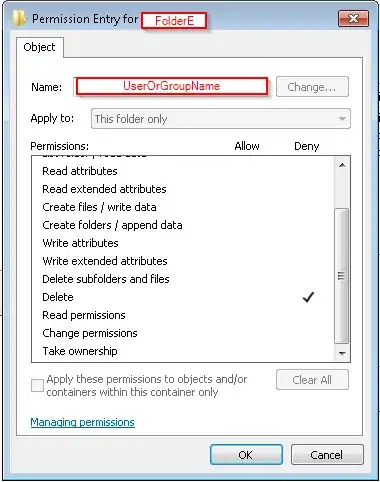

Prevent Folder Deletion or inadvertent Drag and Drop with NTFS security
If you want to prevent a specific folder from being deleted or dragged and dropped elsewhere, even if it has elevated implicit permissions, you can set an explicit DENY to the FOLDER ONLY for the user account or security group which you want to prevent this action from being performed.
You can complete this folder security lock down using ICACLS with a local path (e.g C:\Path\FolderA\FolderE) or a UNC path (e.g \\server\share\FolderA\FolderE).
Example ICACLS syntax to run from an elevated command prompt
ICACLS "\\server\share\FolderA\FolderE" /deny "<UserOrGroupNameToDeny>":(DE)
Permissions Used
/deny user:permission
   Explicitly deny the specified user access rights.
   This will also remove any explicit grant of the
   same permissions to the same user.
perm is a permission mask and can be specified in one of two forms:
   a comma-separated list in parentheses of specific rights:
         DE - delete
What this does
Running the above with those options in that syntax will set an explicit DENY to the NTFS DELETE permission on that FOLDER ONLY to that specific user account of security group.
You can confirm the deny permissions to the folder for the user account or security group by:
  • right-click the folder you've used in the command,
  • Select the Security tab,
  • In the Group or user name: area scroll to or select and highlight the account or group you've used in the command,
  • In the Permissions for Administrators area you will see the NTFS permission attributes for Allow and Deny
  • You'll see a check mark in the DENY column of the special permissions row for the account or group you've used in the command
  • Select Advanced and go to the Permissions tab
  • Check for the Name (or Principal) value that you used in command, for DENY in the Type field
  • The Permissions (or Access) field should show Delete and the Apply to (or Applies to) will show this folder only
