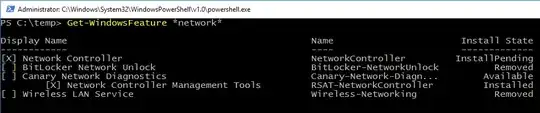

I try to install the Windows feature "NetworkController" on a docker container on Windows 2016 Server TP4, using Powershell. After I run "Add-WindowsFeature NetworkController", I get the message:
"You must restart this server to finish the installation process."
When I now check again (without having done anything else yet) with Get-WindowsFeature, it has the install state "InstallPending".
Now I am not sure what "restart this server" means 100%, but I suppose it means I am supposed to restart the host machine, since there is nothing else to restart (and the container itself is just a container, not a VM as with a Hyper-V approach).

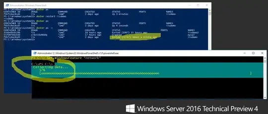

In a second attempt, I add the feature, then restart the docker container without restarting the Windows 2016 server, just running
dock restart iisdemo.
Now something strange happens, when I try to check for the features via Get-WindowsFeature *network*, the process of collecting data stops at 57% and the container exists by itself.
When I attach to the docker image again:
> docker start iisdemo
> docker attach iisdemo
> powershell

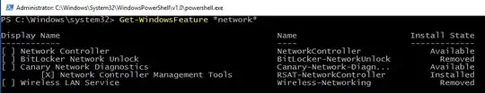

I am back to where I started:
Approach (3)
Another third approach obviously should not work, but I tried it anyway and restarted the Windows 2016 server/host without stopping the docker container at all. Needless to say, this did not work either (same behaviour as approach 1, the container exits at 57% of collecting data).
