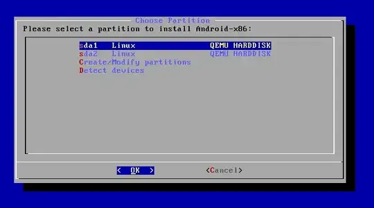

First, select Create/modify partition:
Then create 2 partitions:
  • Create a small (100m) first primary partition for grub. Set the bootable flag. Write changes.
  • Create an extended (logical) partition for the rest, and install android on the 2nd. Grub will go automatically to the 1st one. Write changes.
