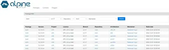

Specifying package versions for Alpine Linux doesn't make sense. Why are you rebuilding your docker containers anyway? Why aren't you using a docker image registry? A registry would ensure package versions are deterministic based on the date of the original build. Alpine Linux seems to dictate package versions based on the version of Alpine Linux. For example when I attempt to update the version of Alpine Linux from 3.9 to 3.17 with specified package versions, the Dockerfile doesn't build and I get the error below.
DockerFile
FROM alpine:3.17
RUN apk add --update --no-cache \
    bash=4.4.19-r1 \
    lftp=4.8.4-r1 \
    curl=7.64.0-r5
DockerFile Build Error
  ERROR: unable to select packages:
  bash-5.2.12-r0:
    breaks: world[bash=4.4.19-r1]
  curl-7.86.0-r1:
    breaks: world[curl=7.64.0-r5]
  lftp-4.9.2-r4:
    breaks: world[lftp=4.8.4-r1]
This makes sense when you look at how Alpine Linux packages are organized so there is one package version per Alpine Linux version.
