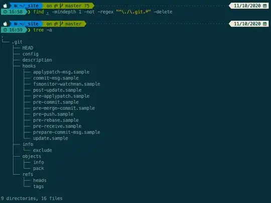

So first, what I did was to write a find . command and see what I'm getting:
Then I wrote find . -mindepth 1 -not -regex "^\./\.git.*" to exclude the .git folder and all its contents:
Now that I'm happy with the results, all I had to do is to pass the -delete flag to my find command, resulting in find . -mindepth 1 -not -regex "^\./\.git.*" -delete:
In case you find command does not support -delete flag, then you can achieve the same result with find . -mindepth 1 -not -regex "^\./\.git.*" -print0 | xargs -0 -I {} rm -rf {}
Be warned, don't use `-delete` or `-print0 | xargs -0 -I {} rm -rf {}`
if you first don't verify that the output you are getting from `find` command
matches your expectations, otherwise, you will lose data.
For my case though, I want to run the command outside of the _site folder; thus, my final command looks like so:
find ./_site -mindepth 1 -not -regex "^\.\/_site\/\.git.*" -delete
