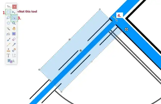

You can do a rectangular selection and then rotate the selection box.
  1. Activate the Select tool, typically shortcut key s.
  2. Draw an approximate (or random) sized square.
  3. Activate the Move Selection tool, typically shortcut key mm.
    • This is a different tool than the Move Selected Pixels.
  4. You should be now able move your mouse until you see ability to rotate your selection box (not the pixels). You can also move the selection box, adjust its size.
    • Tip: Holding shift key while rotating will jump to common rotation angles.
paint.net 5.0.2 visual showcase of tools to rotate selection
