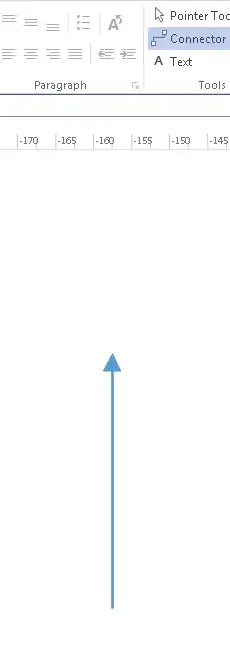

I have added a straight connector:
how can I add to some bends to obtain the following result
I use Microsoft Visio 2013 Professional on Windows 7.

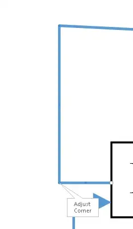

I found the solution on http://packetlife.net/blog/2012/apr/11/drawing-continuous-connectors-visio/ :
A connector can be manipulated so that it spawns additional angles by holding the shift or control key while dragging its midpoint. Holding the shift key will break out the middle of the line, creating four new right angles (the first example below). Holding the control key will create a single angle of an arbitrary degree at the midpoint (the second example below).
Once you have created new midpoint, you can either move the midpoint or the corner, by first selecting the connector:
The midpoints and corners marked with a slightly darker blue that is almost invisible:
