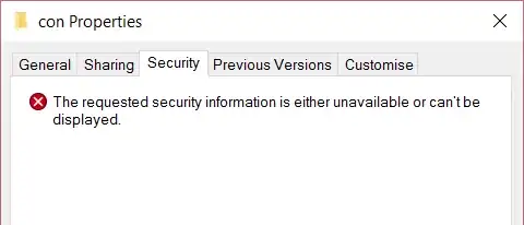

  1. Set the security settings
security settings
