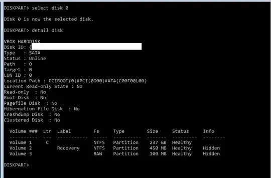

I used windows 10 ISO and through CMD I think non of my partition has property bootdisk = yes.
Please guide, how can I convert this VHD to bootable ?
Update
I find this article,
https://blogs.technet.microsoft.com/jonjor/2011/10/04/vm-does-not-boot-following-p2v-or-disk2vhd/
based on it I tried step, on step 8 I am stuck, please see image below

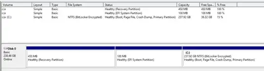

I still have access to physical machine, it only has 1 C: Drive and rest are two System EFI drive + recovery drive.
When I use Disk2VHD, it only shows me 2 drives to copy not 3.

  • System Reserved partition is very important for booting OS. With the screen shot you provided we can't find boot partition and system reserved partition. Make sure your disk2VHD converter is compatible to take boot partition as well – BDRSuite Apr 28 '16 at 19:42
  • Do you still have access to the original system? Showing us the partition table from the perspective of the old system may be useful. – Zoredache Apr 28 '16 at 22:57
  • I bet you have two (or more) disks in your system and the "boot partition" (System Reserved / EFI System Partition) is not on the disk your cloned? – Tom Yan Apr 29 '16 at 10:50

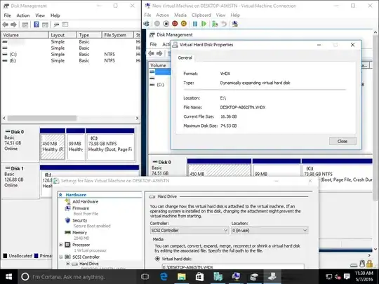

If you have Windows 10 Pro/Enterprise and the Hyper-V feature added, you can also use the New Virtual Hard Disk Wizard in Hyper-V Manager (or the New-VHD PowerShell cmdlet) instead to create a VHD(X) from a Physical Drive:
This does not require you to mount the ESP with mountvol.

  • @TomYan I ended up using Hyper V tool for VHD and it works, thanks – Developer May 10 '16 at 20:38

  • The Hyper-V feature worked, but I also had to set the VirtualBox to use UEFI - common for Windows 10 systems - in order to boot. Might be worthwhile adding into the answer. – Vadim Peretokin Feb 16 '17 at 06:19
