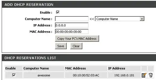

Your router can indeed lease that IP address to another client once the lease expires if your machine is off or disconnected, and doesn't renew it. To guarantee you always get the same IP address, you'll want to make what's called a DHCP Reservation in your router (terminology may vary - see this question for details):
alt text

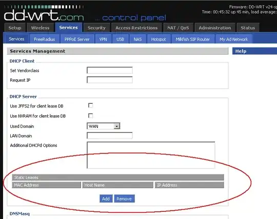

With DD-WRT firmware, you can find this under the Services section:
alt text
