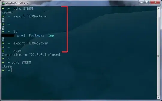

Tested some different TERM settings... Didn't seem to do anything good. Setting TERM=linux resulted the same with xterm.
Different TERM settings
