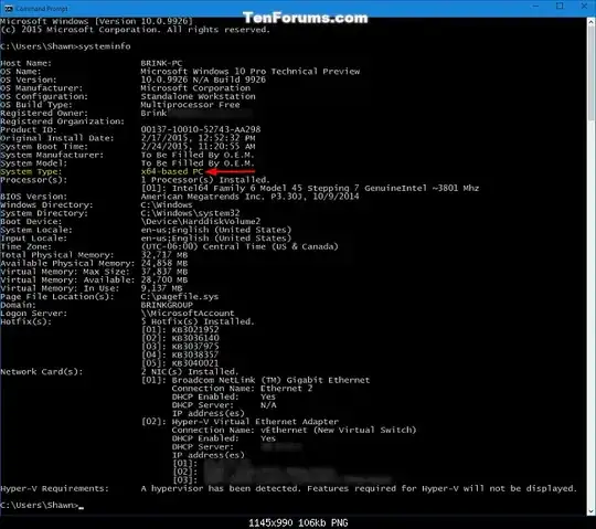

systeminfo
gets many usefull infos like Operating system, System type (32/64 bit) and so long:

  • Yes, I would recommend `systeminfo` also. As you can see from the image above, it will display your operating system as well as other information you may need. – Matthew May 12 '16 at 10:00
    Thanks for the quick reply. `systeminfo` indeed gives the information I'm looking for (hence the upvote), but it takes quite some time (on my PC it takes more than 15 seconds). Therefore I've opted for the `wmic` solution, found in the next answer. – Dominique May 12 '16 at 11:08
    This is what I ask people to run when I need to find out os/version they are running on: `cmd /c systeminfo | findstr /B /C:"OS Name" /C:"OS Version"` – Andrew Savinykh May 12 '16 at 22:56
    systeminfo's output is language dependent, so quite useless if you want ot run it on a larger scale – Stephan May 14 '16 at 18:03
