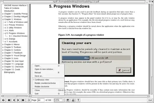

I am trying to configure xpdf(1) so that it doesn't show the outline pane by default.
I've managed to set up a keybinding in my ~/.xpdfrc to toggle the visibility of the outline pane with this command:
bind t any toggleOutline
I wasn't able to figure out to disable the outline pane by default. I found a manual about the configuration file for Xpdf tools however it doesn't help.
xpdf window
Outline is the pane on the left. (The figure has been taken from Wikipedia.)
