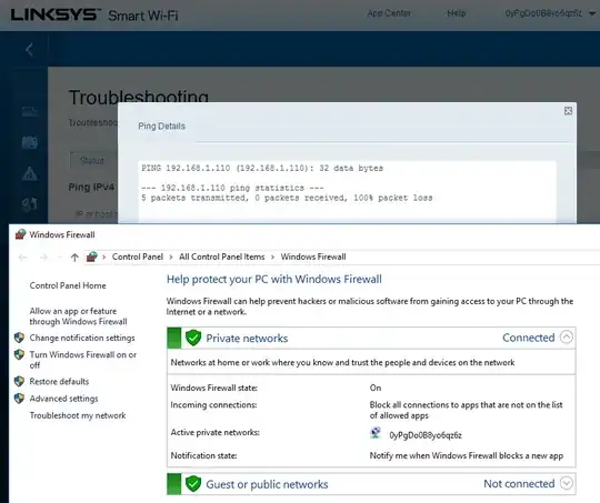

However, with your Windows Firewall on, you won't be able to ping from your router to your PC:

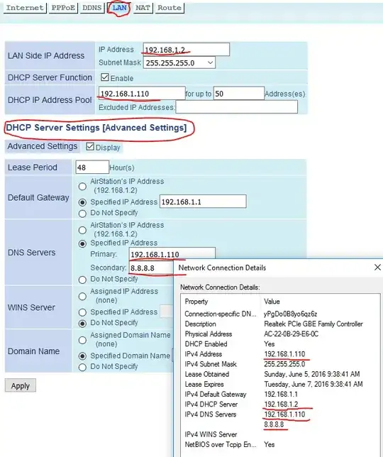

Use 10.0.0.11 as primary DNS server, and 8.8.8.8 as secondary; I am not sure how exactly you did that, but certainly, you can configure on the client side statically:
Or through the LAN-side DHCP server setting:

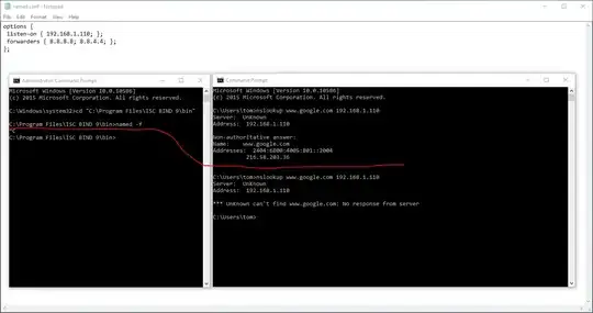

But certainly, first of all you need to have a DNS server built up on your PC:

  • A simple 5 minutes empiric test: 1. install DNS (Simple DNS plus just few clicks) on a PC with 10.0.0.11. 2. Setup one zone `test.com` with one A record there `www`. Disconnect ethernet cable. 3. Try `nslookup` `server 10.0.0.11` and try `www.test.com`4. then do `server 127.0.0.1` - behavior is the same and both can translate the name correctly. Your theory is falsified by this test, because there is no router connected at all. – Vojtěch Dohnal Jun 06 '16 at 15:00
