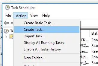

My suggestion is to use the Firefox's built in feature that allows you to take screenshots of single DOM element.
Just pop open the developer tools → Find the element → Right Click and take screenshot
It didn't work on one of my internal site so cannot say it will work for all.

    Thank you so much for your answer (and great image!), but unfortunately this does not answer the question. I need to take a screenshot of the entire page including the element, not just of the element itself. – RockPaperLz- Mask it or Casket Jun 13 '16 at 19:14
    @RockPaperLizard actually @pun's answer DOES answer your question... he just didn't apply it to your use case. You can follow his answer but select the `` element and it will give you the desired screenshot. – Digital Chris Jun 13 '16 at 19:34
    If you edit the height of the DOM element so there are no internal scrollbars then use FireShot to capture the whole page, it should work. –  Jun 14 '16 at 17:52

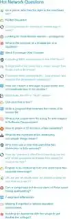

To capture a single element you can use its css selector with the --selector flag e.g.
screenshot --selector #hot-network-questions
will get you the image below

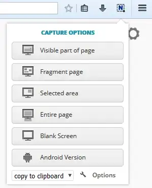

There is an extension called Nimbus Screen Capture which is perfectly suited to this task.
You have the option to capture:
  • the visible part of the page (useful to not include the browser elements as opposed to alt+Print Scrn)
  • a fragment of the page (whereby you can hover over regions on the screen in order to find the fragment you want - these regions correspond to their underlying HTML elements)
  • selected area (you manually click and drag where you want the screenshot, supports scrolling while dragging)
  • the entire page
nimbus
Keith Hall
  • 391
  • Thank you for your answer, I appreciate it. Unfortunately, it does not look like Nimbus Screen Capture can capture the entire contents of a scrolling *element* within a page. If I'm mistaken, could you provide more detail on how to accomplish this with that tool? – RockPaperLz- Mask it or Casket Jun 14 '16 at 16:22
  • @RockPaperLizard you are right, it doesn't seem to support this - I had thought that the fragment mode would cover scrolling elements, or that the selected area mode would work but, while the window can be scrolled in this mode, it seems that the scrolling elements can't. – Keith Hall Jun 15 '16 at 08:46
  • Thanks for confirming I just wasn't seeing it. Maybe they will add that functionality to a future version. – RockPaperLz- Mask it or Casket Jun 15 '16 at 09:33
