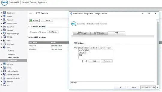

See print screen below labeled as L2TP Server Configuration for what's set there but behind that windows it shows that I'm connected with MS-CHAP V2.
