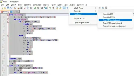

If you have Notepad++ then just select the code then select menu Plugins > NppExport > Copy RTF to clipboard and paste to Word
