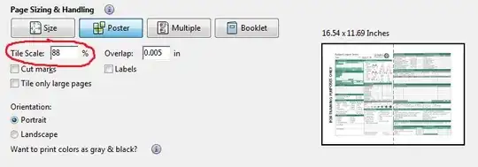

With my A3 file, this by default put it onto a 2*2 grid (i.e. four bits of paper) which certainly isn't ideal. However by experimenting with the value for tile scale you can adjust this to make it down to 2*1:
Print dialogue with modified tile scale showing A3 document printing onto 2 A4 pages
This does obviously slightly scale down the size of your image. However, by reducing the size of the margins in your printer settings you can reduce this effect - with borderless printing Adobe Viewer is quite happy to fit the A3 page onto 2 A4 pages with a maximum tile scale of 94%.
Final print dialogue showing that the scaling can be increased to prevent it getting too small

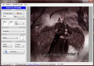

If your printer doesn't support 'banner printing', here's a free application that will do the job (just save the document as A3 sized image):
Easy Poster Printer enables you easily to print posters of any size (max 20x20 meters). Just drag n drop your picture into the application and click print.
alt text

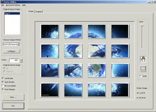

Another free (and open source) Poster Printer:
alt text
