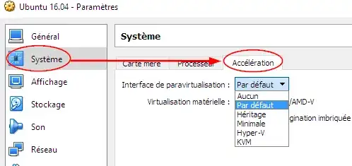

As Charles said, you should check that virtualbox guest plugin is installed.
If you still have the issue try to modify the paravirtualisation parameter of your VM.
In the setting of your machine go to: Systeme > Acceleration Clock Drift virtualbox
Angel115
