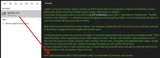

First was the link that showed this:
So I removed this ASUS utility, and rebooted. It already looked better, but required a few more modifications on the Dell monitors.

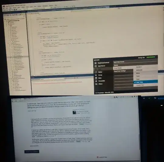

Then I went into the color calibration settings on the monitor itself, and instead of "Temperature", I changed it to "Movie" of all things.
Edit: Just to update in case anyone else has this problem, I've looked into it further and it was mostly the ASUS driver. It turns out that Temperature did actually work the best for me, at a value of 7500K. YMMV.
To me this looks look more "correct", as the white is clearly more white than a newspaper left out in the sun, as you can see in my image below.
Before and after (the laptop looks slightly different only because it was angled wrong in the second one):
Dell U2415 Color Calibration
Keep in mind I have no idea what I'm doing, I'm not a professional photographer. But I do stare at a monitor almost all day, every day, for 15+ years ... so I've gotten used to seeing one thing.
I certainly would not want to stare at this sort of thing at 2 AM, as it's rather blinding. But it's not faded yellow!
