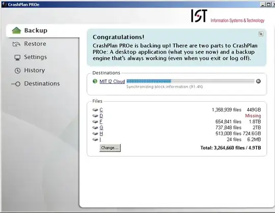

How can I reduce the frequency of "synchronizing block information" phases in CrashPlan PROe? It typically takes hours to complete, seems to occur every two days or so, and in the meantime files don't get backed up.
I use CrashPlan PROe 3.7.0 with Windows 7 SP1 x64 Ultimate.
Example:
To make matters worse, it is followed by a scan:

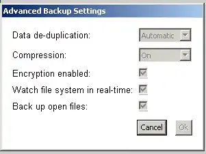

My settings:
My advanced settings (grayed out, it seems that I cannot change them):
The following setting seems interesting but is grayed out as well:

    Frank - I went ahead and added an answer summing up all we've been going over in comments. When you get a chance, let me know if you feel this covers all the discussed topics, options, and so on in the comments; I went ahead and cleaned those up so feel free to do the same with yours. I felt froggy so I jumped... Ribbbitt!! – Vomit IT - Chunky Mess Style Aug 18 '16 at 04:34
  • @PIMP_JUICE_IT awesome, thanks :) I'll keep you posted. – Franck Dernoncourt Aug 18 '16 at 05:07
    @Homey_D_Clown_IT eventually the admin unlocked the "verify selection every", it did the trick. Thanks for your help! – Franck Dernoncourt Sep 12 '16 at 17:09

If You Cannot Change These Settings
If you determine that these options are grayed out, not changeable, or enforced at another level for the way this software is configured and setup in your environment you'll want to see where else these changes may need to be made to be effective on your client workstation.
According to the same admin guide in Advanced Settings, you will see there is an option with a little lock symbol enter image description here indicating whether or not these settings are locked and preventing users from changing this value from their personal settings.
Consider the following options but don't limit to yourself them only:
  • See if there's a setting in the client interface to unlock these so the changes can be changed
  • Check a higher level in your configuration setup with this software to see if these settings can only be changed (unlocked) from a server policy or configuration file—check with your server or local PC admin if this is not you.
  • If you have support with this software, reach out to [them] the vendor for support to assist in resolving the issue.
