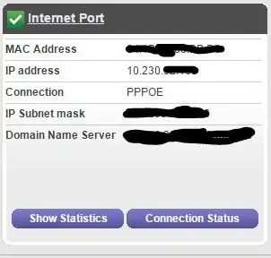

I understand 192.168.x.x is our local IP address, and the public IP is some other. I used this site to get my IP, and the result:
But in my official ISP's site and my Router's login, it is as follows:enter image description hereenter image description here
My router and ISP shows my an IP, while the website shows me another IP. What is my actual IP address? And why am I assigned multiple IP addresses?

    Your ISP is likely using [Carrier Grade NAT](https://en.wikipedia.org/wiki/Carrier-grade_NAT). – DavidPostill Aug 13 '16 at 15:11
    @DavidPostill as someone who uses the same ISP as OP, can confirm – Sathyajith Bhat Aug 13 '16 at 15:11
  • So what is likely to be my actual IP? (I am asking so that another computer can establish a connection with my computer, as I wrote a java program for that). – Siddharth Venu Aug 13 '16 at 15:12
  • @Sathya Nice to know I'm right again :) – DavidPostill Aug 13 '16 at 15:12
  • @SiddharthVenu Please read [Alternatives to Port Forwarding & NAT](http://portforward.com/help/alt-to-pf.htm): "There are four major problems that you may run into that would require alternatives to port forwarding. " ... – DavidPostill Aug 13 '16 at 15:13
  • @DavidPostill so I cant use that 49.xx.xx.xx as there are many ISP customers sharing the same IP. So could I use the 10.230.x.x? But it will just be the address my ISP has which is not visible outside right? – Siddharth Venu Aug 13 '16 at 15:17

51
Your internet provider is using Carrier grade NAT. Your local (to your house) IP address is 192.168.x.x. Your local (to your ISP) address is 10.230.x.x. The public, routable IP which you are sharing with many other customers of your ISP is 49.207.x.x.
