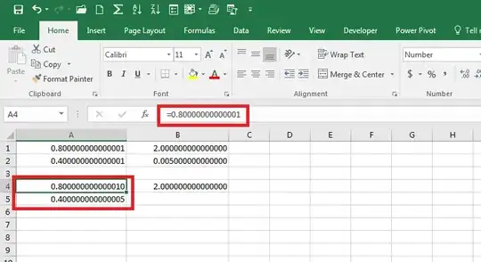

Excel supports Floating Point arithmetic, which has a limit of 15 decimal places. Here is the investigation and reference. enter image description here
In researching this subject, it is found that only 15 digits are stored in arithmetic quantities, due to Floating Point Notation as suspected.
After searching for this suspected culprit, the reference is found here: https://support.microsoft.com/en-us/kb/78113 and here https://support.microsoft.com/en-us/kb/214118
So, 15 decimal places is the maximum carry over in floating point. Here is the same example in 14 decimal places. Note the 5 in the 14th decimal place; presents further demonstration of the Floating Point limits. enter image description here
To test a theory, commented by a member in this forum, I decided to add this addendum. No, not even in VBa can the Double variable surpass the Floating Point limitations. I used Double precision and returned the value as String to demonstrate even further here: enter image description here
