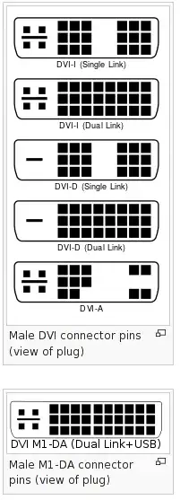

The monitor specs would hopefully tell you whether it accepts VGA through the DVI connector. Otherwise, you may be able to at least rule it out by looking at the monitor's DVI connector. The DVI connector configurations look like this:
DVI connector
The analog signal is carried on the four pins shown on the left, surrounding the horizontal bar. If the monitor can accept an analog signal on the DVI connector, it must have contacts in those four positions (although it could be a generic connector, so the presence of contacts there doesn't guarantee that they are used by the monitor). If you look at the monitor's connector and there are not contacts in those locations, you can rule out doing what you want with a passive adapter cable.

But in some rare instance your monitor have a male connector, check and see if it has 4 pins surrounding the large flat pin.
If it only has the flat pin, then your monitor only accepts a digital DVI (DVI-D) connection. Since VGA is analog, no cable will work. You will need an active converter to make it work.

  • So your monitor only accept DVI then. You still need to check if your monitor can support analog signals. You will need to check your monitor's documentation to see if it does. Also, the DVI cable you're using must be a DVI-I cable. Check and see if it has the 4 pins surrounding the large flat pin. If it does, then it should support analog. If it doesn't, then you need to get a new cable. Again, before getting a new cable, check and make sure your monitor is support DVI-I connection. It would help tremendously if you can tell us your monitor's model number. – turbocomppro Aug 21 '16 at 18:34
