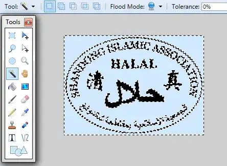

With Paint.NET use Brightness/Contrast like this:
Paint.NET Brightness/Contrast
If you need it transparent, use the wand with 0% tolerance and flood mode global, click on a white region and then press Del to delete the white background.
Paint.NET wand global flood
