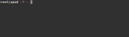

You might be interested in context-color, which I've put together for that exact purpose: https://github.com/ramnes/context-color
It's a simple script that, when executed, outputs a color based on a command output's hash. With it installed somewhere in your $PATH, you could do something like this in your .bashrc:
export PS1="$(context-color -p)$PS1\[\e[0m\]"
(where --prompt/-p is the switch so that the color is escaped for prompts, and \[\e[0m\] the escape sequence to reset color)
By default, the command used to generate the hash is whoami; hostname. If you just want the color to change according to the hostname, you can change the $CONTEXT variable environment (export CONTEXT="hostname") or simply use the --context/-c option (context-color -c "hostname").
See below for an example:
demo
