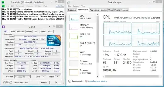

  • excessive ACPI.sys activity can indicate a Core is running too hot and is getting either heated by slugware , dust or insufficient air flow or user OC changes in BIOS run faster than stock rate and/or higher Vcore
  • Investigate the above possible causes and report back with temperatures of Core.
  • Hopefully they are <60'C and if not try to reduce number of slugware or useless processes, services and startups. ( using tool like Speccy for T(cpu) or equiv)
If you report back probable cause or more questions, I can append actions. good luck.
Take Note below . Even though I only have 8GB and a slower CPU, it runs cool 2%CPU with 58 processes using browser, email, search everything,Process Hacker, Dropbox, Skydrive, Teamviewer, WinPatrol, etc enter image description here enter image description here
