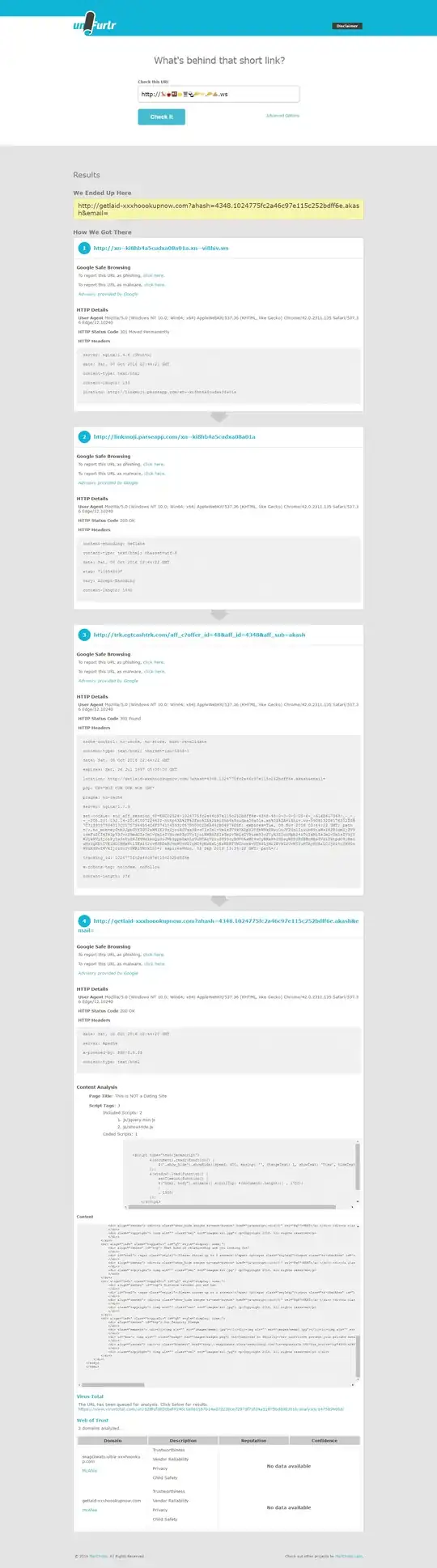

This is amazing! I had no idea you can use emojis in a URL, even though I'm a web developer! The other answer are great, but I found Unfurlr to work well. It allows you to see where something goes, without setting cookies in your browser, and without exposing you to a virus or drive-by-download as you would if you view it in your browser. It also shows you headers and scripts and contents if you need to safely inspect it more closely.
http://unfurlr.com/
