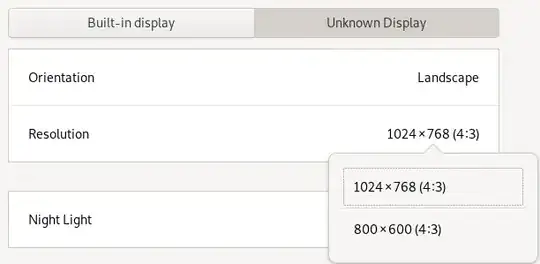

This answer is a repeat of the accepted answer above with a specific focus on Gnome and an explanation of how to find the device name. I was trying to connect a second screen to my laptop under Debian GNU/Linux 10 (buster) with the Gnome desktop. The recommended resolution for that screen is 1920x1200. The issue was that the resolution was lower and there were only 2 options available in the setup menu:

Devices can be seen in /sys/class/drm/ the available resolutions are visible in the modes file:
$ cat /sys/class/drm/card0-DP-2/modes
1024x768
800x600
800x600
848x480
640x480
$ cat /sys/class/drm/card0-eDP-1/modes
1920x1080
1920x1080
In my case the name of the screen in question is DP-2.
Enter device name in boot parameter
On Ask Ubuntu, this answer explains how to add a new resolution to the kernel boot parameter.
sudo vim /etc/default/grub
Then edited this line
GRUB_CMDLINE_LINUX_DEFAULT="quiet video=DP-2:1920x1200@60"
Then update grub:
 sudo update-grub
After a reboot, the new resolution becomes available:
