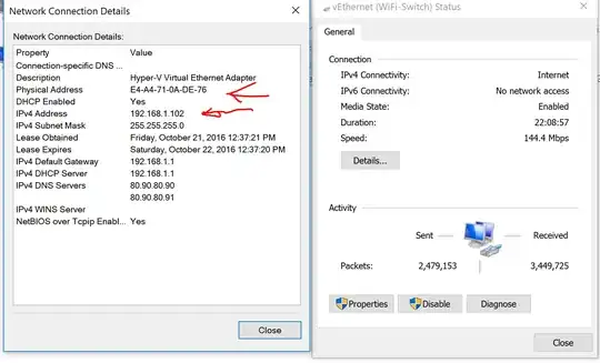

I have Hyper-V installed on my Windows 10 laptop and have configured a Ubuntu VM on it. Ubuntu network adapter is connected with the external virtual switch I have created. With this configuration I would expect that the host and the guest should get different IP address from DHCP server. However they are both getting the same IP and I can't pinpoint the cause. Below are the print screens of virtual switch, network adapters on host, host network status and guest network status.
Here it's the virtual switch configuration
The network adapters on the host
Host configuration. Notice MAC and IP
Guest configuration. Notice MAC and IP
Can anyone see what's wrong in this configuration? Also, what should I change so both the host and the guest get their own IP and are presented independetly on the network?

Some DHCP servers always assign the same IP address to the same MAC.
Since your upstream is a regular (non-WDS) Wi-Fi connection, it can only have one MAC address – not multiple. The only reason Windows even allowed you to put it into a bridge is that it performs L2 NAT (arpnat) for you, rewriting your VMs' packets on the fly.
u1686_grawity
  • 426,297
  • 64
  • 894
  • 966
  • Please explain, because I see the computer MAC as E4-A4-71-0A-DE-76 and the VM as 00:15:5d:01:67:00. – harrymc Oct 25 '16 at 10:54
    The VM has its own MAC, yes – but the router doesn't see it. (Similar to how all your hosts have 192.168.x IPs, but the internet doesn't see them.) – u1686_grawity Oct 25 '16 at 10:58
  • An external virtual switch is supposed to act as a virtual network adapter. Why wouldn't the router see the VM's MAC? Such a statement needs some official source. – harrymc Oct 25 '16 at 11:01
    Because there's a Wi-Fi connection in between. The VM's network adapter doesn't separately associate to the Wi-Fi AP, it has to piggyback on the host's existing association – and the Wi-Fi frames just don't have a separate field for the 'original' MAC address. The AP assumes that the device which did the Wi-Fi handshake is the the same that's sending packets. – u1686_grawity Oct 25 '16 at 11:37
  • This makes sense. However is there a workaround to fix it? – Albert Oct 26 '16 at 15:59
    Either use routing instead of bridging, or see if you can make the VMs include something like DHCP client-ID / DUID in the lease requests... If this were e.g. Linux, hacks involving the not-quite-standard "WDS-bridge" (aka "4addr") Wi-Fi connection mode might be possible, depending on AP. – u1686_grawity Oct 26 '16 at 16:21
  • It does not solve the problem, but it's the right explanation. I'm going to use an Ethernet adapter instead of WiFi. – Albert Oct 27 '16 at 08:14
    @Albert: That's exactly what [my answer](http://superuser.com/a/1138747/8672) says. See the link in the answer for details. – harrymc Oct 27 '16 at 16:02

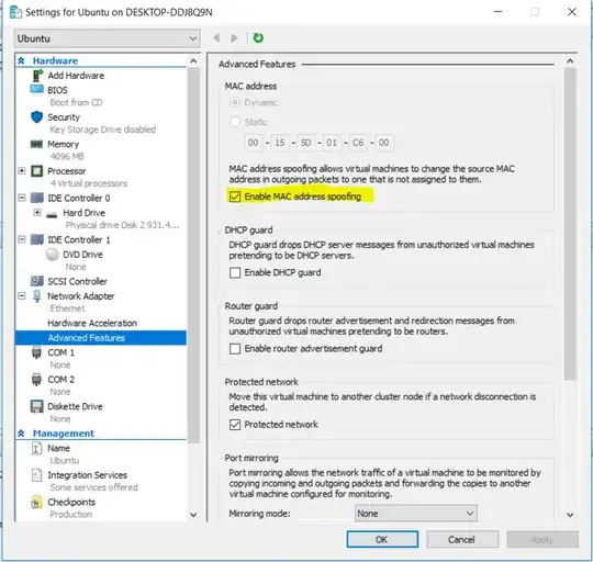

You can fix this, by going inside the VM settings:
Network Adapter/Advanced Feature and then
either apply a static MAC or dynamic MAC, but then you need to
Enable MAC address spoofing.
To make sure that VM will use a dedicated and spoofed MAC to act like a real network device.
Enable MAC address spoofing:
