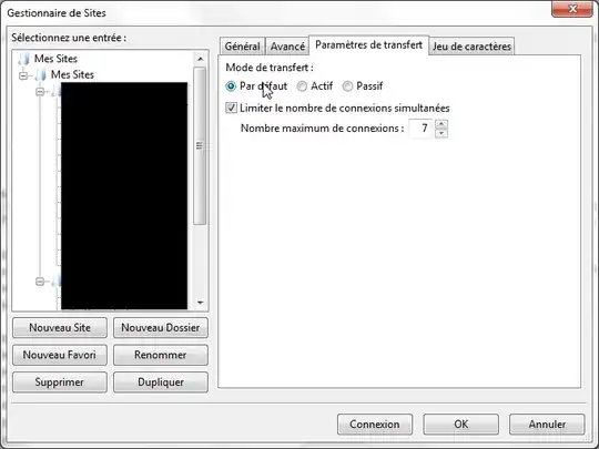

I've setup a ftp connection with filezilla client
The transfert mode is default. I've tried with passive and active mode too but regardless of the mode, the result is the same
Once setup, I'm clicking to connect.
