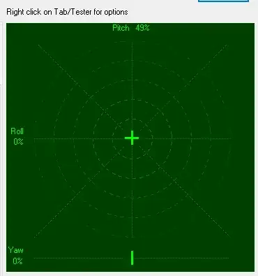

Then I stumbled over this tool here (http://www.xedocproject.com/joystickcurves.html) and decided to try it. As far as I could see, it emulates virtual game controllers so you can modify the input translation. Wouldn't work for my problem as I found out, but the interesting thing was, that I had the exact same behavior like in the game. The tool has a windows where you can see how your input translates, and there, in neutral position of the stick, the program also thought that I pushed the stick forward. So I thought, there must be more to it.
I hope you could follow me so far. Here are some screenshots of this tool (Joystick Curves), so you can really see what I mean:
Stick in Neutral Position:
Stick pulled back 100%
Stick pulled back 50%
Stick pushed forward 100%
As you can see, the Y-axis just translates wrong here, and I have the exact same behavior in IL2. All other axis are working fine, everywhere, even in IL2.
