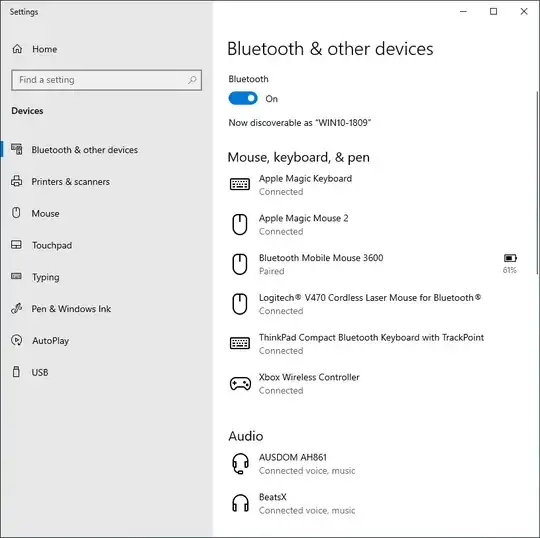

10/3/2018 update:
Windows 10 update 1809 is finalized (build 17763) and I think it's a good time to clarify what it does and what it doesn't.
As far as I've tested, it supports only Bluetooth LE (Low Energy) devices that use GATT Battery Service to report battery information. If you are using Bluetooth LE mice/keyboards, those devices are probably OK. But most other devices including headphones, headsets, and Classic mice/keyboards are not supported by Windows 10 and 3rd party software is still needed.
I also tested the latest Insider preview release for the 19H1 update (build 18252), but it's the same as 1809. Following is the screenshot from 1809. All of these devices are capable of reporting battery information, but Microsoft's "Bluetooth Mobile Mouse 3600" is the only device Windows 10 can display the information.

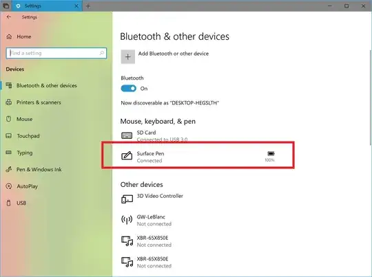

"Apparently" Windows 7 and Windows 10 have support for checking the battery status. For checking battery status of a Bluetooth device on Windows 7, here's a tutorial from Lenovo. (https://support.lenovo.com/us/en/solutions/ht070699).
Also, here is an image that shows a control panel item for Windows 10 (though I am not sure of the legitimacy of it [https://i.stack.imgur.com/OKsrX.jpg ])

  • Neither of those work natively, and rely on custom drivers (with proprietary coding for battery levels, which are most likely not relying on the GATT service per se) or custom software (the second picture). I am looking for a universal solution that can read GATT code off devices regardless of what driver is being used. This is a part of the current Bluetooth stack if I am not mistaken, and should not require additional tweaking. It's definitely missing from W10 at the moment, but as @music2myear has commented, it might be deployed soon. – Afzal Apr 11 '17 at 19:40
